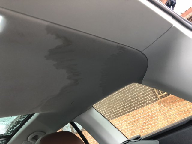

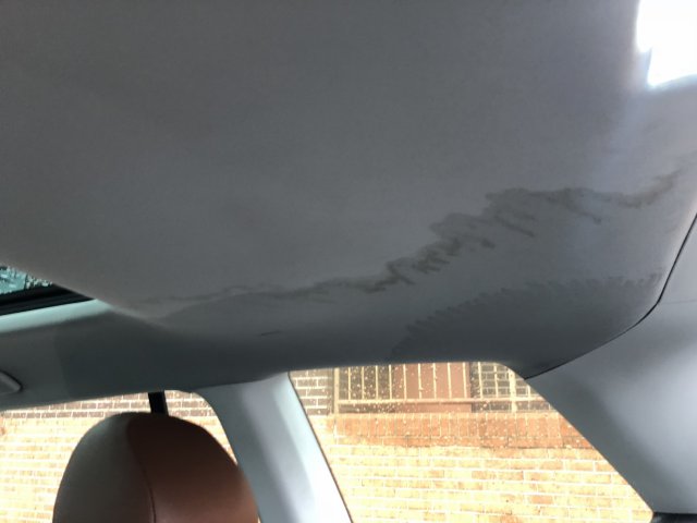

Hi everybody, I guess I'm not the only one. I bought a used 2017 Alltrack SE with only 20k miles two weeks ago and have already had two bad leaks from heavy rain. I bought mine from an independent auto dealer, not a vw dealer. First heavy storm the car sat out in heavy rain for 1.5 hours before I found it. Headliner stained all 360° around the pano sunroof. Both A pillars soaked, water dripping down below the dash/steering column. Dripping off the ceiling console near the lights/sunroof controls.
Took the car back to the dealer, they were very nice and "un-clogged" the drain plugs free of charge. Spent an hour getting the water stains out once they had dried. The fix seemed to work as I made it through another bad rain storm, then a few days later another heavy rainfall and there are two huge water stains in the back on the headliner and the carpet in the spare tire well was completely soaked. Took it back to the dealer and they un clogged the rear 2 drain tubes because apparently they only did the front tubes last time.
After reading all of the issues in this thread I'm sure this will only be a temporary fix and it will leak again. I have no warranty and my VIN returns no available recalls. I have seen some people were able to make this into an insurance claim to cover the bill. I may be too late for a buyout since the car is now 4 years old and I purchased from an independent dealer. Love the car but this is truly awful. Buy the S trim people
