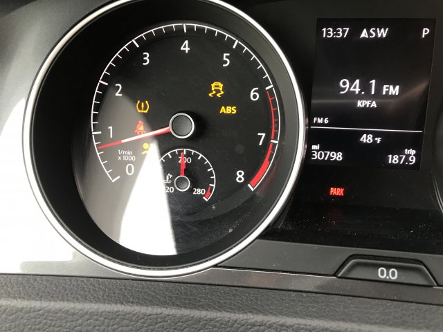

Well hello! I'm late to the party, and if I had one hint of this problem, I'd be driving a Honda or about anything else. Perhaps this is why Alltrack are be closed out? Bought a 2017 2 years ago, had a few strange but self-resolving issues with the radio/nav, warning lights...suddenly 2 days before Christmas, 4 warning lights just swung up. We're having a fairly wet season here in the Bay Area [CA], but I didn't see it as cause and effect. Took it to the dealer even thought they set reset a day later [cause they DRIED OUT! duh]. That's when the FUCK VOLKSWAGEN began, AGAIN! Dealer 'oh yea, we know about that, you gotta be careful, it's really expensive to fix' ME 'It's a 2 year-old car, WTF?!?!?' Dealer 'hey we'll take care of it, it's under warranty' ME hypertensive emergency, walks around the block. No recall notices, no Service Advisories from VW NA even though EVERYONE SEEMS TO KNOW ABOUT THIS WELL DOCUMENTED FLAW!! Is this not Lemon-Law applicable? Our service center had the car for a day and replaced 4 CORRODED wire connectors and some wiring, cleaned the drains. I want them to own the problem and buy it back. Anyone else out there looked into this. I'm a VW loyalist but this is it! Last reliable VW I had was a 74 Squareback. I had a 97 Jetta that leaked like a sieve, and a 2008 GTI that ate it's own wiring harness. Bye-Bye VW

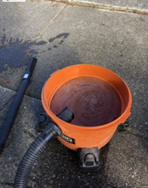

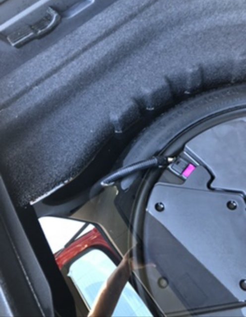

Add me to the list! 2017 Alltrack and I just pumped about 12 gallons of water out of the trunk. Going to the dealer on Thursday and I am at 32K miles so hopefully they cover with warranty. With an active TSB they should address I would hope!
I have been parking on a driveway that slopes up, can that make it worse? I mean no matter what angle I park at my two year old car should not have a trunk full of water, but seems like it never happened until recently when I was parking at angle. We also get so little rain her in California it could just be a coincidence.
View attachment 653 View attachment 654
That is crazy, but we always park nose down, so maybe if that much water is being collected, it would account for the extent of the electrical damage. I ran our VIN in the VW USA site and there are NO service recall or other advisories. And please don't tell me, VW USA that this problem won't pop-up again, that's pure bullshit. I'm going to have to look into a lemon-law procedure
