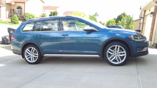

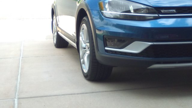

Went back and forth on various after market wheels, Replikas and some OEM VW, Audi..... new and remanufactured.
Finally decided on the Helix came with some Beetle and Passat? A dealer selling online thru Amazon at decent price.
18X8 48mm, heavy though at 27lbs. But I like the look, not racer boy or out of place. But different enough to not be stock.
Continental Pure Contact 225/45 beef it up just enough.

Those look great. VW OEMs look good across many models including those. Re: Toyo Observes - I have them currently on my Tiguan and they were unstoppable this last winter (first time for snow tires on it). While we don't get a ton of snow, I have to climb up two large hills to where we live and we had a few big snows and I was pleased how well they peformed. I had to come to a complete stop on the last hill during one storm (cars scattered all over the road) and waited on icy/snowing road, but when the cars cleared, I had no issues taking off and moving along. I know there are lots of good options for snow tires, but my local Les Schwab is close and they gave me a good deal on those and some snow wheel take offs. After driving them all winter, they still look new, so I'll try them for the AT. Funny, most of the reviews I read after I bought them were mostly positive, but I think overall, Toyo puts out a good product (had some on my old truck that were excellent as well).
