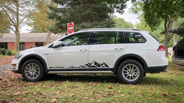

Greetings! As I have done with every other vehicle I have had, I am starting a timeline thread to help me keep track of progress. I am coming out of a 2017 Alltrack S manual that was totaled in August 2018 by a 26 year old girl running a red light.

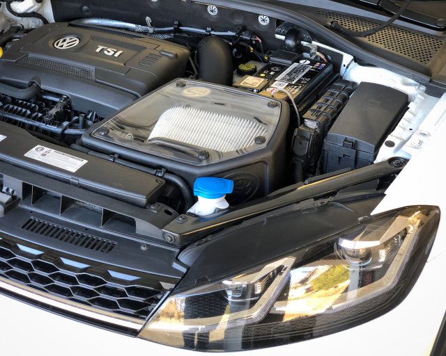

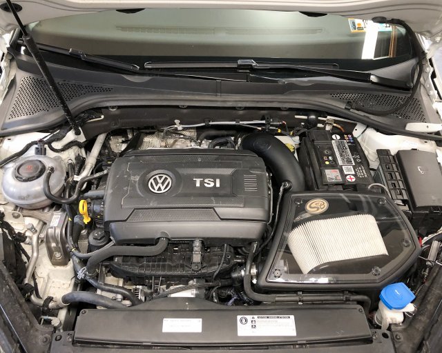

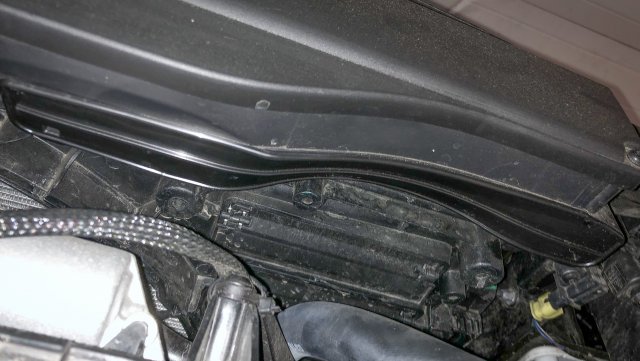

I ditched the CTS intake and picked up an S&B intake and while it takes up a lot of room, I noticed a difference in fuel economy and I got rid of the unnecessary noises. I also added an OEM block off (5Q0-129-849) to the rad support which forces more air to the intake.

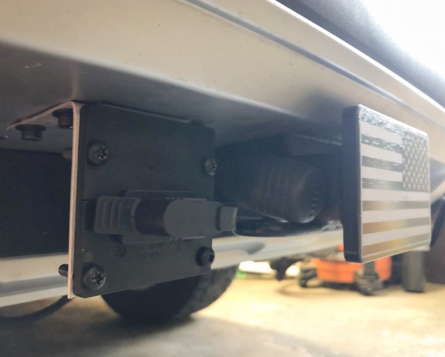

After a lot, and I mean a lot, of research, I was able to wire up an OEM trailer module so that when I plug in a trailer, the ABS module compensates with braking and stability. It also will tell me if I have a trailer light out on the car display. There are a lot of added bonuses to this and I need to get off my ass and write it all up for others to be able to do it as well.

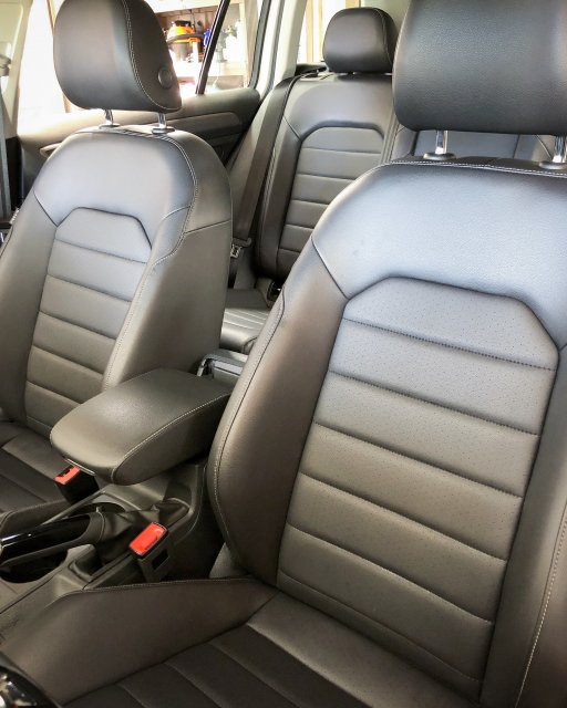

Lastly, I drove to South Carolina just to pick up a set of SEL seats, front and rear. My wife had been complaining about her back on long trips and this was a pretty good deal, minus the 1,400 miles to drive and get them. I had to make adapters to make them plug and play because they were out of a 2015 TDI wagon but again, worth it.

Sweet update! Any noticeable difference with the S&B intake?

@thebeardeddetailer how hard was it to install the "DIY hatch release button". What kit did you use?
